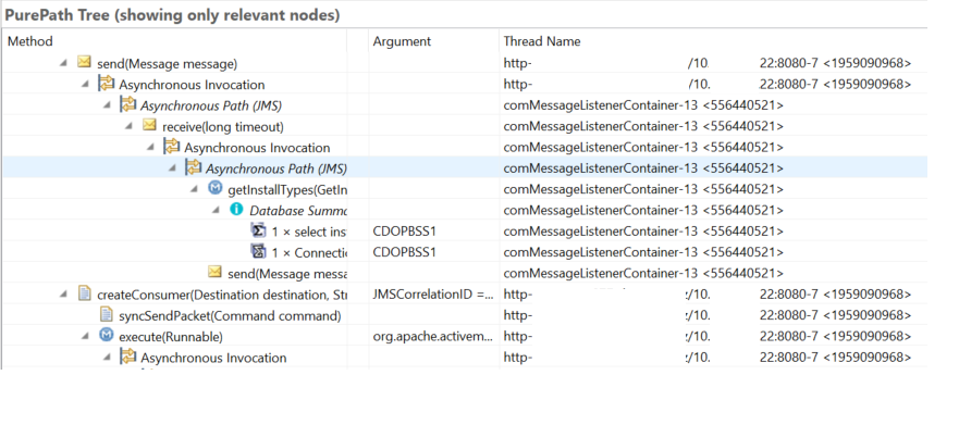

So in AppMon we are able to see the Thread Name of methods in a tree as shown in this screenshot.

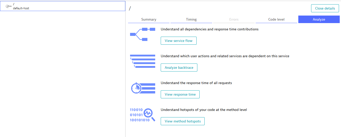

Is there a way to achieve something similar in Dynatrace. Is it shown in one of the Analyze options or Under Summary/Code level tabs?
This also branches into my next question, Is it possible to see the contents of a sent message in a PurePath?
As an example, we run some b2b transactions using an ESBmule application and have used messageID's from inside the message (using AppMon) to track down log details.

We are adding Message Correlation Id and Message Id to the PurePath view. The same is true for Thread Name and id.
