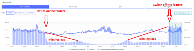

Some weeks ago I tested the cross environment oneagent feature. When I turned on I received unexpected low load problems at some services, screenshot is attached. Simply the services traffic were not collected.
This was the result at some services:
