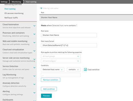

I have dozens and dozens of naming variations on FQDN in my host names where it's HOSTname.FQDN. These variations are messing with my automatic tagging rules.
All I care about is the host name for each host to make my auto tagging rules be more effective. What would be the best way to tackle this? I'd like to trim everything to the right of the first dot in a host name.

Hi Shakib,
You should be able to do that using regex and Host Naming option, under Settings > Host naming. Here is a regex rule that should take care of anything after the first dot. {Host:DetectedName/([^\.]*+)}
This will be applied to the entire environment automatically so any hosts you instrument with the oneAgent and follow the same naming convention you mentioned, will only show the first part of the name up until the dot.
servername.datacenter.region > servername
I hope this helps!
That worked like a charm! Thank you @Mo_Azuz!!

The tagging rules are a lot easier to implement and manage when the host names don't have the FQDN. I don't need the detected host name to change, I just needed the way the host names appear within the GUI to be without the FQDN. Moe's suggestion above gave me what I needed. Thank you, though 🙂
