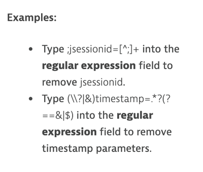

From the example given in the UI I'd assume one defines capture groups in the regex and the capture groups would form the "new" url value.

The examples look similar, though all seem to only work for query parameters, not for URL paths.
