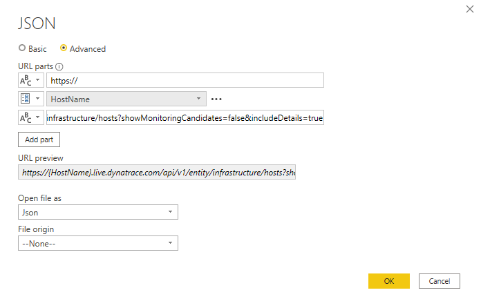

1. in your powerBI report define a web data source with the url for the API you need (for each query you need a different data source on the report).
In this data source you can also use parameters such as host name and token so that the report may be reusable for other tenants if you need it.
This example gets a list of the hosts in the environment.
DON'T FORGET to add the http headers required such as the "Authorization" for the token and the "Accept" to specify you expect json data.

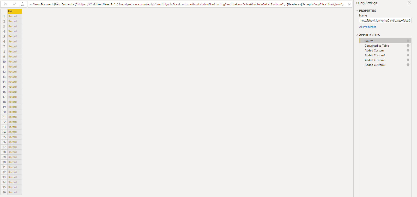

2. Once the data source is defined, because it is in JSON format, you need to convert it to a tabular format. In the example above it's simple, but it could be that you'll need to traverse through the JSON result first until you get to the array part that includes the result. Once there, "Convert To Table"
The above shows the results of the initial data source results. Use the "To Table" button to convert it to a table. Once pressed, you'll that the yellow header now shows Column1 instead of List.

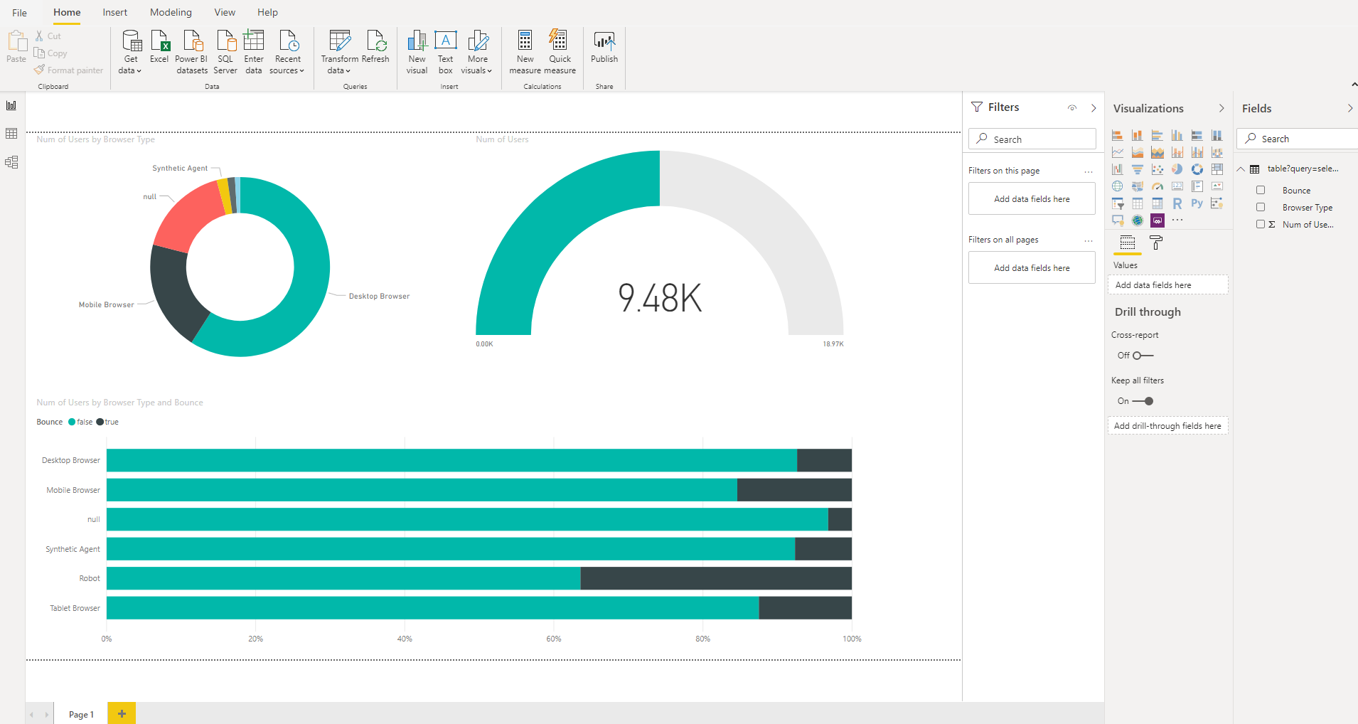

4. Once you apply and save the query you are ready to build your report. Just choose your visualizations and drg the columns from the right part to the visualizations.

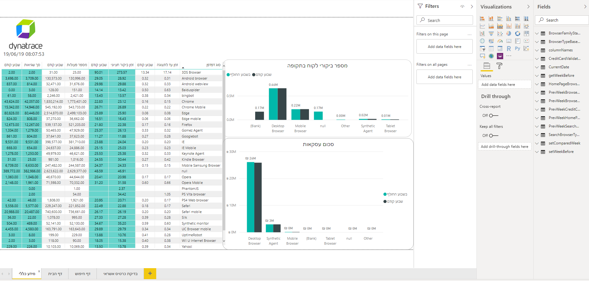

For example:
or
In the last example you can see on the right many queries used for the reports and green/black columns in charts represent time periods comparisons.
