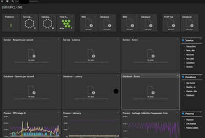

Need help - I have installed OneAgent in full stack mode for 8 servers for 2 different application and created MZ,
Now for my master dashboard I am not getting all the data as needed, I needed Databases, Services, Process and Host Health Data.
However, I am looking to get the below data.
How should I troubleshoot this and get the relevant data for DB and service dashboard.

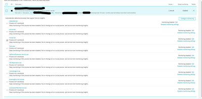

From this picture above it looks like the monitoring has been disabled for these services. Are these services the ones you are expecting to see monitored?
Yes, These are process/services i want to monitor and want to be available on Dashboard.
I have turn on deep monitor and will restart those services, Can this will also bring the data for my database services ?

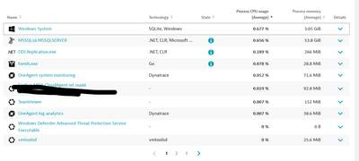

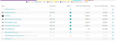

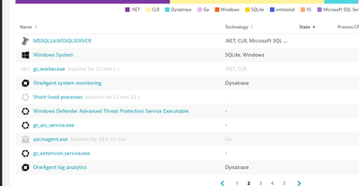

Which processes are needed to be restarted.? As there are 7 host and 100+ processes
For ex below -
I would say:
  • Check those are pending to be restarted. Dynatrace tells it to you in Status column, and you can review them in Dynatrace Status section as well.
  • Check databases processes, and checks which processses are talking to that database process.
In general I would say application servers + Java / .NET. You can review How database activity is monitored.

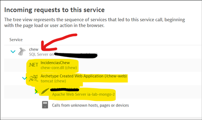

Let me paste an screenshot about database service "chew". This view is backtrace:
That database service was automatically discovered because .NET, Apache and Tomcat processes were restarted and they are living in hosts in Full stack mode.
Best regards
I am curious to know what these info icons say next to DOTNET processes.
ALso, are these DOTNET ones calling the database?

This cant be done this is my master dashboard for 100+ applications
I need to find a way to get service and database data on it
