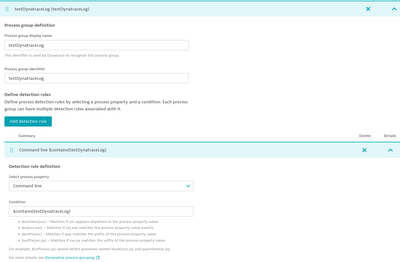

Following previous question, I had to create a lot of process group definition in a Declarative process grouping.
I didn't find in the document the maximum process group definition per technology/declarative process grouping we can add ? What is the default limit ? Can we extend it ? Is there best practices to share here.

Hi Simon,
by default there is indeed a limit set of up to 400 rules in total, however this limit could be changed at the cluster level.
As for best practices (from my experience), since the DPG rules can generate some more load trying to find all new processes if left too general, try and make them a bit more specific or even pinning them down to Host Groups or even Hosts.

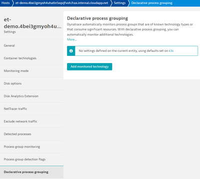

For the best practices, I didn't see a place where I can reduce the scope of the DPG :

04 Apr 2022 01:58 PM
Hi Simon,
in order to define a scope you can achieve this either via the API or UI.
Go into the setting for the e.g. Host and under the Declarative process grouping tab you can define these rules that will only run on that specific host. (for Host group would be analogous)

04 Apr 2022 02:13 PM
OK yes, of course, I was in the global settings...
Thx !
