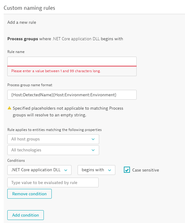

What we did was set a process naming rule that adds in the <HostName>-<Environment> and then the process name. That way the Process is named: Host 1 - DV1 - securityscan. Then all problems and charting are pretty explicit as to where its coming from and what it is. You can also add in Application name and such. The possibilities are up to you!
