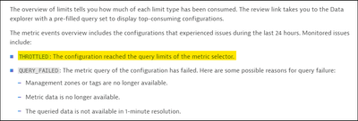

For the throttled logical status the Dynatrace documentation states the following "You can monitor all metric dimensions within one configuration (for example, it is possible to create an alert for 20,000 CPUs in a single metric event configuration). As a safeguard, Dynatrace throttles these configurations with a limit of 100 simultaneous alerts. You can narrow down the scope of the event to particular dimensions."
Click the link here to see it for yourself and explore more.
