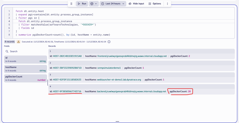

you can try this one it's fetch hosts has processes of technology `DOCKER` then summarizes by count of docker pgi per each host
fetch dt.entity.host
| expand pgi=contains[dt.entity.process_group_instance]
| filter pgi in [
fetch dt.entity.process_group_instance
| filter matchesValue(softwareTechnologies, "*DOCKER*")
| fields id
| summarize pgiDockerCount=count(), by:{id, hostName = entity.name}
I've added id field without renaming to be able to inspect it with app host.
BR,
Mostafa Hussein.
12 Nov 2024 05:09 AM
Thank you Mostafa! That worked really well for my edge case.
