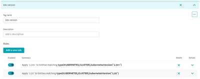

Hi @alexandrumarin, it is not a perfect auto-tag rule, but this is the only way I could figure out how to do it at the moment. The downside: you'd have to set up multiple tag rules to cover all the k8s cluster versions and you'd have to maintain them, but at least you'll have a tag that can be used for filtering.
Perhaps someone out there has a better, cleaner way of handling this, or hopefully the optional tag value and/or k8s version would be options in tag rules in the near future.

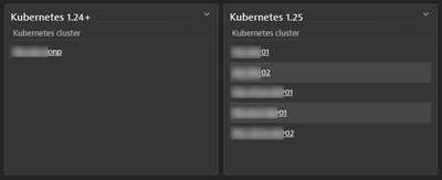

The tag can then be used with the K8s Node Count metric; deselect the Kubernetes: Node count column to only display the cluster name.
The result on a dashboard:
