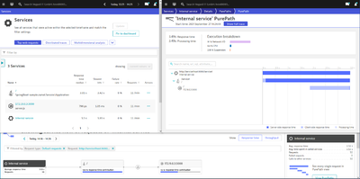

Actually, there is a solution. We have been facing the same problem in monitoring an application with Camel integrated. We couldn't see the full Pure Paths as well as the full detailed Service Flow.
We could solve the problem through using Camel with integrated Opentracing. Dynatrace offers One Agent Settings that allow to monitor Applications with Opentracing and Opentelemetry. You will have to activate some settings (according to your environment) as shown in the following Screenshot:
After activating those, you'll be able to see fully detailed Pure Paths and Service Flow. See the example below. For demonstrating purposes we sent a request from a Spring Boot Client through 2 Camel Services -both with the camel-opentracing-starter- to a NodeJS server and got a response the same way back:
Without active Opentracing Monitoring:
Active Opentracing Monitoring:
Further on it is important to not let Camel filter out -depending on your configuration-  the Dynatrace or Opentracing header.
