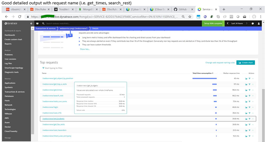

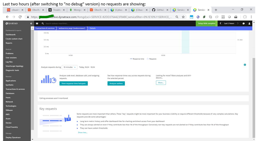

Hi guys,
Prospect add SDK to their python code and every thing was great till they switch off the debug mode flag.
Is that a must to work with debug on or we miss something here?
With -d 1
Without -d 1
