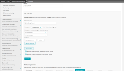

First thing you'll need to do is set an automatic tag, you can set it at the Host, Service and process level:

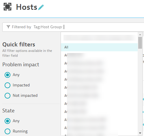

Once you've done that, give it a while to start setting them within the UI.  Then go to your Host list, and filter on Tag:Host Group:

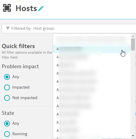

You can also use the HostGroup filter out of the box:

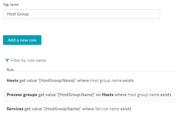

Hi There, if I understand your use case, you can create an automatic tag rule. That should get you the dropdown list of all HostGroups anywhere you want to filter by hostgroups. Here's an example of the tag rule:
