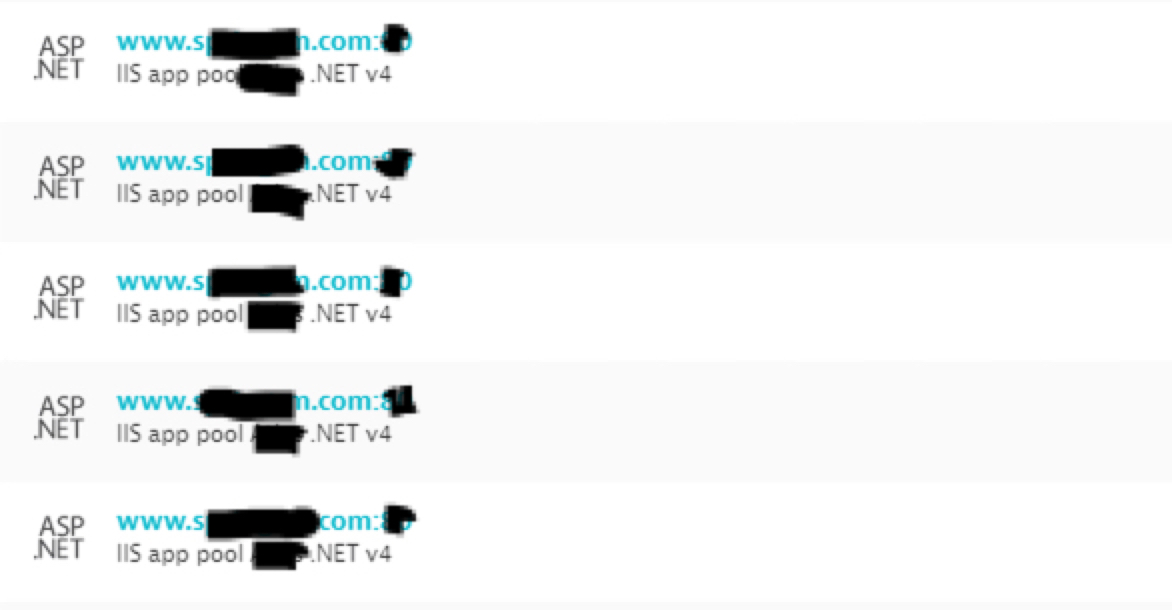

Noticed the same service is being triggered based on host groups have been defined and it is causing duplication of the same service. I am not able to merge these services.
Please suggest how I can show all transactions for these services under one service without any changes to the host group?

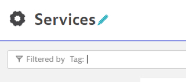

make sense @James K. Since that is not doable, can I apply a Tag for each host group so that I can filter the host group on Services? Could you suggest how to apply a Tag with the same name as host group? Appreciate your help!

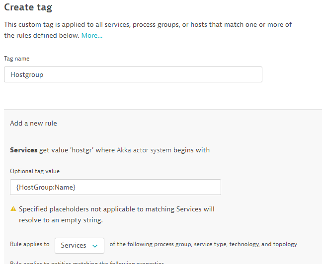

There is a placeholder that you can use for this - it can also be used in a service naming rule. If you keep the host group as-is I would recommend that so it is obvious which is which:
