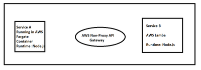

We have a few services instrumented with both Dynatrace agent & OTEL manual instrumentation. These services are mainly running in Fargate containers & Lambdas, runtime is node.js
Services that are instrumented with dynatrace agent are sent to Dynatrace UI, whereas for same services that are instrumented with OTEL manual instrumentation are sent to other visualization layer(Lightstep).

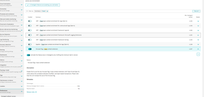

We have noticed that enabling one of the dynatrace feature 'Forward Tag 4 trace context extension' is actually overriding OTEL trace ID and replacing it with Dynatrace trace ID. This feature is mandatory for dynatrace to connect AWS services(received this from support). This is a big red flag for running Dynatrace and OTEL in parallel. Because of this our leadership team is looking to remove dynatrace agents and this has become bigger issue now. Has anyone encountered the same issue and were you able to resolve this issue.

Here is our architecture:
Below is the documentation we followed to instrument AWS API Gateway non-proxy integration:

Below is the dynatrace feature we have enabled.

The OneAgent feature Forward Tag 4 trace context extension is needed in this setup to ensure that the trace started by a OneAgent code module is continued by the dynatrace AWS lambda layer. If the feature is not set OneAgent doesn't set traceId/spanId on propagation headers resulting in a broken OneAgent trace.
