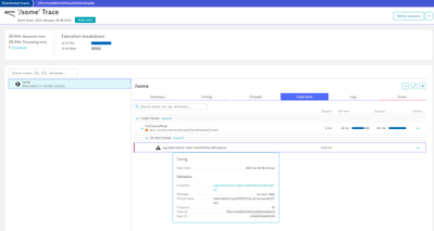

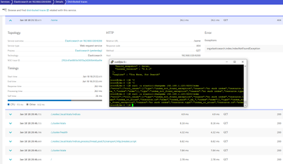

If you have, for example, an instrumented Java application that calls ElasticSearch - you can see request count, failure rate, response time for OPAQUE service (not instrumented). Dynatrace can see when the code of your application executes a call to another service and when it came back.
You can see how it look in Dynatrace - with fully instrumented ElasticSearch on screenshots.
In my case, I call elastic with curl. So I can see this call and PurePath because ElasticSearch is instrumented - agent in Full-stack mode. I can see exception and e.t.c.
I wouldn't be able to see these CURL PurePaths without instrumentation.

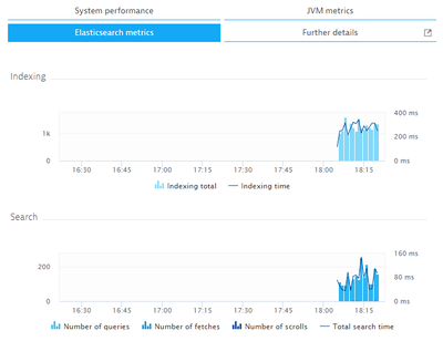

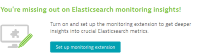

In infra only mode you can additionally setup extension to get ElasticSerach metrics:
