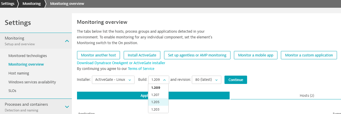

19 Jan 2021 09:02 PM
Looks like it doesn't like the version of the ActiveGate you're using. Haven't dealt with this before personally but if it's like OneAgents it might be that that version of AG is no longer available on that environment (e.g. it's older and none were connected).
You can check here to see what versions are still available. The fix i f so (and I would try this anyway) would be try with the latest ActiveGate version.
