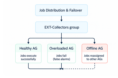

So, I had a similar question so i had a conversation with an AI bot and the response I received i thought was helpful.  So, found this post and will add it so it's available to Community.
ME: i have some questions about Dynatrace Extension 2.0 ActiveGate grouping. If i have 3 ActivGates in a group named EXT-Collectors and I run an Extension 2.0 extension such as SSL Certificate Checker on that ActiveGate group, will Dynatrace automatically spread the load across the 3 ActiveGates or will it just assign some number to each ActiveGate. I ask because what if one of the 3 activegates crashes, will it still run the extensions. OR what if one of the ActiveGates have too much load on the host, will Dynatrace move some of the jobs to another ActiveGate with more resources available?
BOT:
I know exactly what you’re asking — because Extensions 2.0 ActiveGate execution doesn’t work quite like Synthetic locations or OneAgent failover, and the way Dynatrace spreads jobs can surprise people.
Here’s how it actually works for Extension 2.0 on an ActiveGate group:
1. Load distribution
  • When you assign an Extension 2.0 to an ActiveGate group (e.g., EXT-Collectors with AG01, AG02, AG03):
    • Dynatrace splits the monitored entities for that extension across the AGs in the group.
    • The assignment is static at deployment time — meaning each monitored endpoint or instance gets bound to one specific ActiveGate for execution.
    • It’s not dynamic load-balancing based on CPU/memory like Kubernetes — Dynatrace doesn’t shuffle jobs around minute-by-minute to follow spare capacity.
2. Failover
  • If one ActiveGate in the group goes down (e.g., AG02 crashes or loses connectivity to the cluster):
    • Failover happens automatically — the endpoints bound to AG02 will be reassigned to other AGs in the group.
    • The reassignment isn’t instantaneous — typically there’s a short gap (depends on execution interval) until the next execution cycle picks a healthy AG.
    • When the failed AG comes back online, the workload may shift back again.
  • This is per monitored endpoint, not per single execution run — so you won’t get “half a job” moving mid-run.
3. Load awareness
  • Dynatrace does not actively monitor ActiveGate resource utilization to balance jobs dynamically in real time.
  • The scheduler’s logic:
    1. Try to spread endpoints evenly across AGs in the group.
    2. If an AG becomes unavailable, redistribute those endpoints evenly across the remaining AGs.
    3. When the AG comes back, re-balance again.
  • If one AG is technically online but pegged at 100% CPU, Dynatrace won’t “evacuate” jobs — you’d have to remove it from the group or fix the host.
4. Best practices for your case (SSL Cert checks)
Since you have ~900 SSL checks and three AGs:
  • The system will initially give each AG ~300 endpoints.
  • If AG02 fails, AG01 & AG03 will each take ~150 extra endpoints until AG02 recovers.
  • Keep intervals staggered to avoid all jobs firing at the same time (reduces CPU spikes).
  • Watch the ActiveGate Extension Execution metrics (memory, CPU, job queue length) in the AG self-monitoring dashboard — that’s your early warning for overload.
  • If one AG is consistently busier (e.g., more expensive checks), you can manually reassign some endpoints to balance them.
In short:
  • Yes, Dynatrace spreads the jobs across all AGs in the group, but in a static evenly-split way, not CPU-aware load balancing.
  • Yes, failover happens automatically if an AG is down.
  • No, it will not shift load away from an overloaded-but-online AG unless you intervene.
ME: so if an AG gets overloaded will sciprts start to fail and timeout, causing false alarms?
BOT:
Yes — that’s exactly the risk.
Here’s what happens in Extension 2.0 when an ActiveGate is overloaded but still technically “alive”:
1. Why it causes false alarms
  • The scheduler will not migrate jobs away from an AG just because it’s slow or pegged at 100% CPU.
  • If that AG’s extension worker queue grows too long:
    • Jobs execute late → time-sensitive checks (like SSL expiry checks) may miss their window.
    • Jobs exceed their timeout → the extension reports a failure for that endpoint.
  • Dynatrace treats those failures as real — so you get problem alerts, even though the target system is fine.
2. Failure behavior
  • Each monitored endpoint’s check is independent, so if one AG is stuck, only the endpoints assigned to it will start failing.
  • The other AGs in the group keep running fine.
  • If the AG is completely unreachable, failover kicks in and jobs get redistributed — but if it’s merely slow, Dynatrace assumes it’s still capable.
3. Impact on SSL checks (your case)
With ~900 SSL checks split 300 per AG:
  • If AG02 gets overloaded (CPU spikes from heavy DBI, VMware pulls, etc.):
    • Its ~300 SSL checks may start failing or missing intervals.
    • You’d see a burst of SSL expiry “problem” events, even though the certificates are fine.
    • When AG02 recovers, those problems close — but the noise already went out.
4. How to prevent it
To avoid false alarms from overload:
  • Monitor AG resource metrics:
    • CPU %, memory usage
    • Extension worker queue length (ExtensionExecutionController.executionTime, ExtensionExecutionController.queueLength in AG self-monitoring).
  • Distribute heavy jobs intentionally:
    • If certain SSL checks have long TLS handshakes (or slow endpoints), put fewer of them on a single AG.
  • Stagger execution intervals:
    • E.g., instead of all 900 running at 10:00, spread them in small batches over the hour.
  • Capacity plan:
    • Keep each AG at ≤60% sustained CPU during peak to leave failover headroom.
  • Have a hot spare:
    • Running 4 AGs in the group but only loading 3 to capacity means failover doesn’t overload the survivors.
Bottom line:
If an AG is overloaded but up, yes — Extension 2.0 scripts can start failing and cause false positives. Dynatrace won’t auto-move jobs until the AG is fully down. You need to keep headroom and actively watch the AG’s self-monitoring metrics to avoid that trap.
