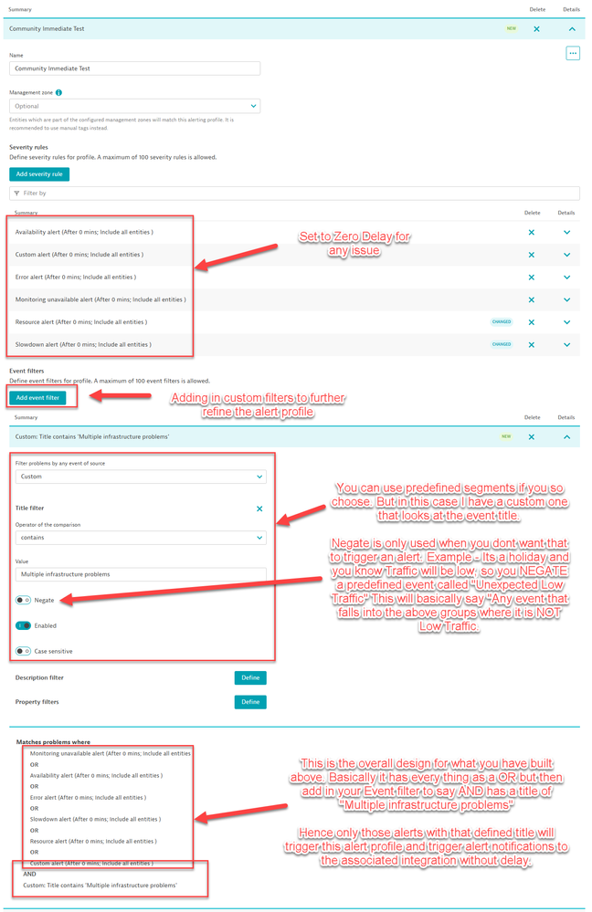

Multiple infrastructure problems typically is generated after multiple, problem cards are built and are merged into one. Without knowing your overall Alert Profile I would recommend the following as a fail safe. Build a net new alert profile that is triggered immediately and add in an event filter to focus on "Multiple infrastructure problems".
Here is a simulation:
-Chad
Thanks much for your response.
Are you able to test this out successfully? I've tried filtering with title "Multiple infrastructure problems" I didn't work for me.
