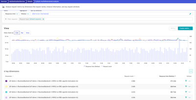

I think you could use MDA to view this information. You could use {Service:instance} as a dimension, so you can chart the response time by instance.
If each instance is running in different datacenters, that will work.
