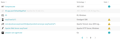

Have you checked if the processes are fully monitored in your case. For example in the screenshot below, some processes need a restart[yellow icon] and some of them have other issues[one with "i" icon]
RB
Thanks for feed back / idea.
That's the crux of my issue : my host is reported full-stack. We rebooted host. My PG is reported as instrumented fine (no warning icon, no info icon). AFAIU the technology of my PG is known and supported by OneAgent full-stack / injection function.
Maybe I am missing something more conceptual, which would explain I cannot see these connections.
