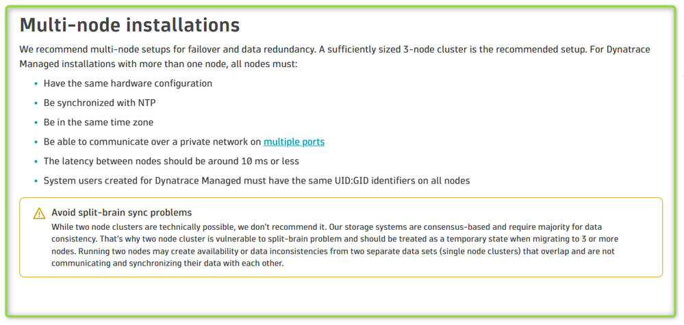

  • For the multi-node deployments, ensure the attached requirements are fulfilled:
https://docs.dynatrace.com/managed/shortlink/managed-requirements#multi-node-installations
