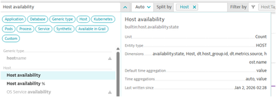

is this okay to use below built in metrics for this ?

Yes it is. You just need to play a little bit with the metric selector and add a delta transformation so you can easily create a metric event when hosť is turned on.

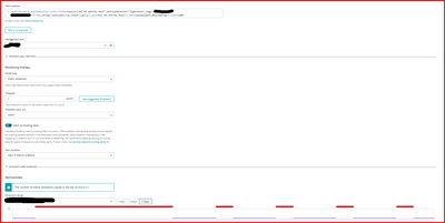

I have added a host tag filter and split by host , now the count is 1 and host number at x axis is four.
If we have created a metric event for this we need to add static threshold to 1 if the limit ?
I am confused here what to select as after selecting alert on missing data i am getting threshold number raised from 1 to 10
metric selector - builtin:host.availability.state:filter(and(or(in("dt.entity.host",entitySelector("type(host),tag(~"code:A1233"~)"))),or(eq("availability.state",up)))):splitBy("dt.entity.host"):sort(value(auto,descending)):limit(20)   -
I am bit confused here what to do next ?
