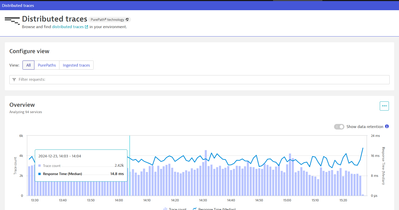

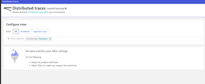

I am getting the distributed traces for my application and webservices -
but service type database is empty getting no result for the selected management zone

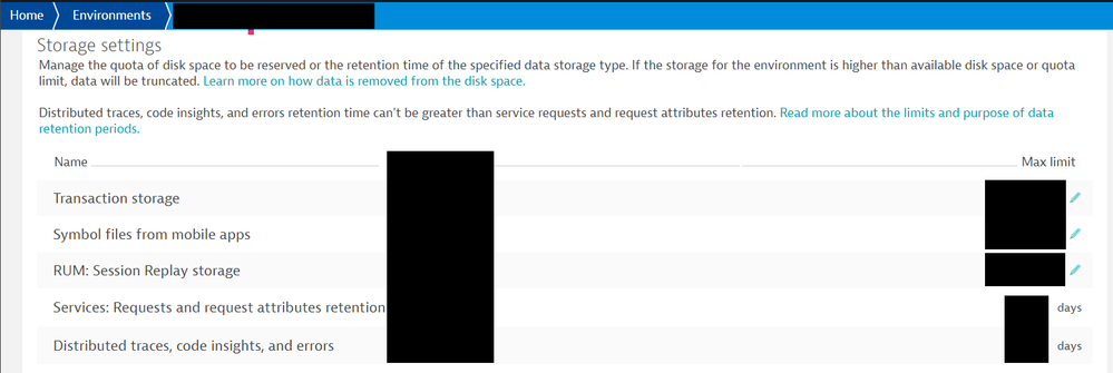

Hi @Adi_10
Kindly check the storage and retention settings on the monitored environment to ensure there is no issue with the data retention as per the attached example:
BR,
Peter
Checked no issues here at monitoring environment, as other management zones are getting the data for DB services
