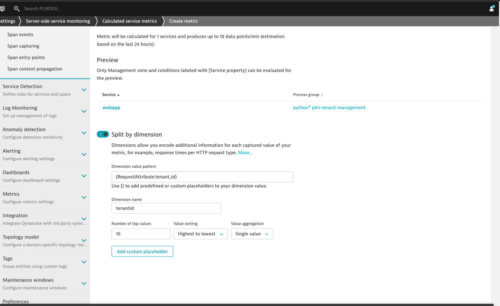

Hello,
I could only create one dimension on the calculated service metrics page in Dynatrace. I would like to add additional dimensions to my custom metrics. How do I do that?

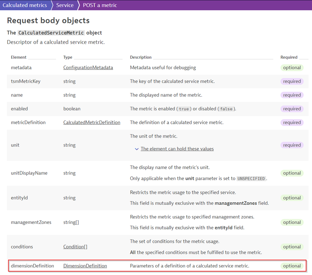

Hi @icecoolcat
It is possible to define only one dimension for a calculated metric. The field "dimensionDefinition" of the Dynatrace API for "Calculated metrics - Services" is not an array (such as with Management Zones). So, unfortunately you can't do that (not via api and not in the UI).
Link: Dynatrace API documentation (Service metrics API - POST a metric)
