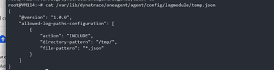

Thanks @PacoPorro for your response. I believe I had gone through this already. In-fact I created .json file under this path /var/lib/dynatrace/oneagent/agent/config/logmodule to allow .json file to discover by OneAgent.
"@version": "1.0.0",
"allowed-log-paths-configuration": [
"directory-pattern": "/tmp/",
"file-pattern": "*.json",
"action": "INCLUDE"
I included the above content as the json file to override the security rules, but however after configuring Ingest rules and when trying to add json file path under Custom Log Source, I am seeing below warning message.

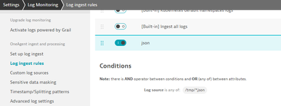

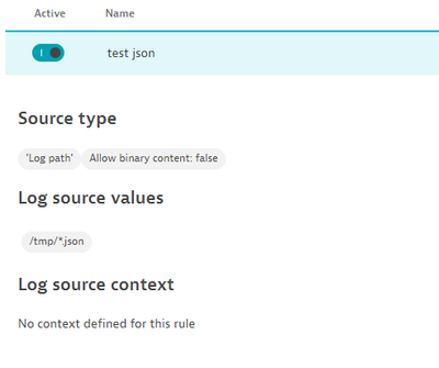

I created your rule
Agent restarted just in case.
Custom log source created. I ignored the security rule warning.
Added the ingest rule.
