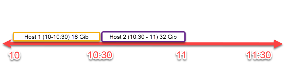

So in your case, we have two hosts, Host 1 = 16Gib and Host 2 = 32Gib. Both of them running at different times resulting in non-concurrent timing. which can be depicted as such.
So what I would expect you to pay, per your rate card.
- 1 Hour for Host 1, because the monitoring time incurred is 30mins which be rounded to the nearest hour when usage is greater than 5 mins.
- 1 Hour for Host 2, because the Size of the host doubled, So Dynatrace isn't seeing this as a 1 to 1 continuation of the powered down host. This too has a 30 min monitoring window where the usage is greater than 5 min, so it gets rounded to the nearest hour.
Here is the verbiage on the 5 min monitor rounded: "If a host runs for less than 5 minutes, it doesn't count against your host unit hour quota. A host running for 5 minutes or longer is rounded up to 1 host unit hour."
So, all in all, Host 1 = 1HU x 1 Hour x $<Rate Card Value> = Host 1 Cost | and | Host 2 = 2HU x 1 Hour x $<Rate Card Value> = Host 2 Cost | Add both resulting values = your total cost to monitor.
I have put in a request for Dynatrace to out line the Hours monitored for hosts, That way if a host spins up and spins down during peak hours or business hours, it would be nice to look at a host over a 6 month spread and say "Ahh, this has only been monitored for 730 hours which = 1 Month. Therefore you'd be able to really formulate showback/billback to charge teams exactly for what they use per host.
So in short, Both Hosts will incur a 1 hour monitoring segment resulting in a value of 2 total hours (Summed) then you'd add in the Host Unit Multiplier where Host 1 = 1 HU and Host 2 = 2HU.
