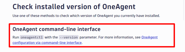

You can check here how to check OneAgent version from UI and command line.

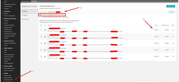

1.- From Deployment Status:
     Deployment Status / filter by host group or name of host / Look Version OneAgent.
     (Recommended disable check of Show new OneAgent)

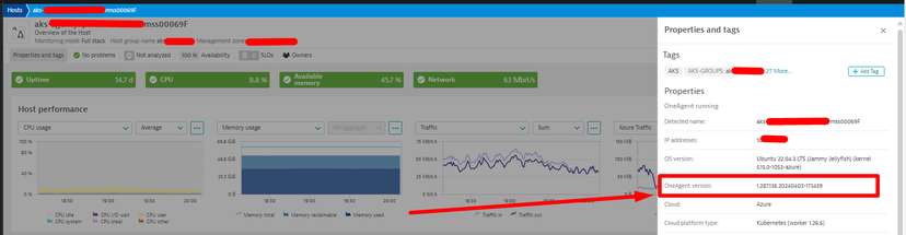

2.- From Host
     Looking for the particular host, in properties
If that is not enough and you still want to see it from the server, if necessary run oneagentctl with the --version parameter inside the server you want to see the version: https://docs.dynatrace.com/docs/shortlink/oneagent-update-linux#oneagent-command-line-interface
