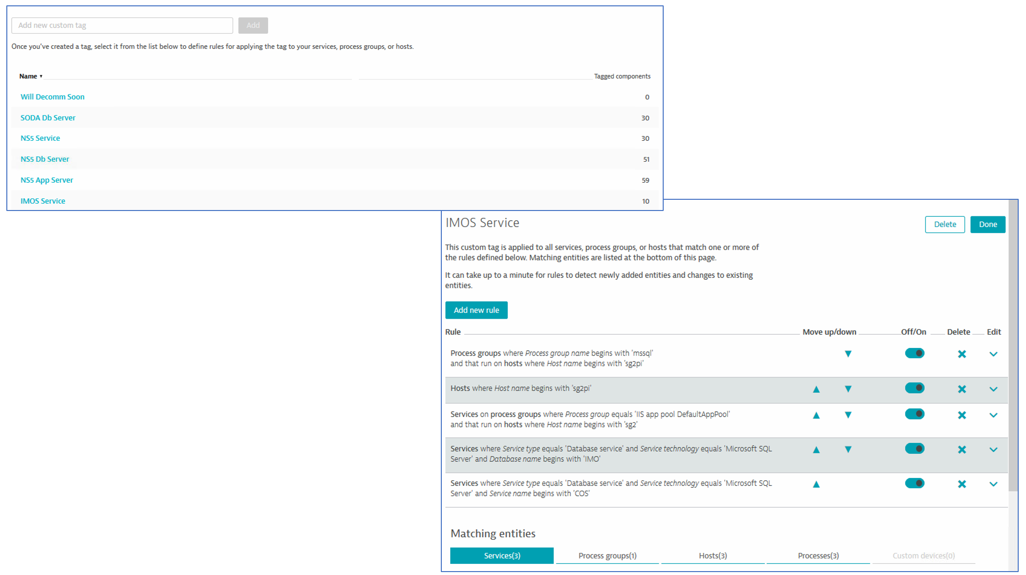

It appears that I can only change the rule associated with the tag, but cannot rename the tag.
Is that correct?
If it is, is there any workaround other create a new tag with the exact same rules, then delete the old one?

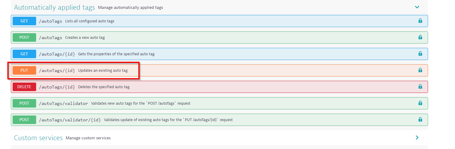

15 Nov 2018 08:14 AM
This is possible now, via the new Configuration API, currently an EAP.
There is a PUT Endpoint for /autoTags/{id} which updates an existing auto tag.
