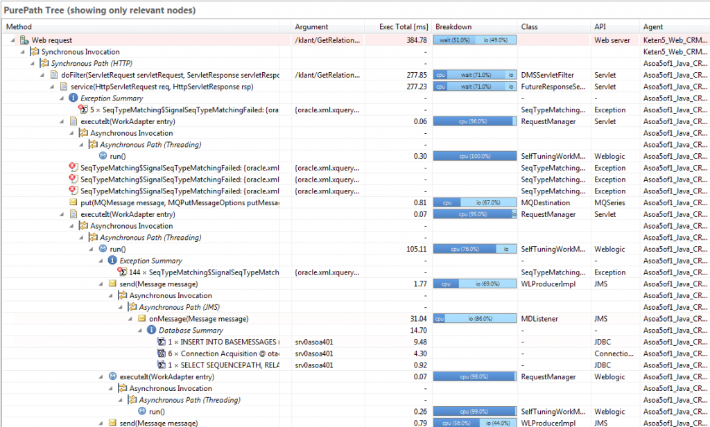

I've not used AppMon, but from what I can see from the pictures, in previous product the PurePath contained all the methods in the call line by line.
In Dynatrace we can only see the service entry point and sampled method hotspots.
What do you think is the main reason for Dynatrace to stop supporting this feature? And can you give me some suggestions about how you guys analyze the whole call stack without adding every single method as a Custom Service? Maybe another tool or a technique I am not aware of?

Yes, but I can never see something similar to picture below;
It is much more detailed and readable than method hotspots. From what I understand in Dynatrace we collect stacktrace samples.
Does AppMon work the same way? Or does it collect data from every single method in every service call?

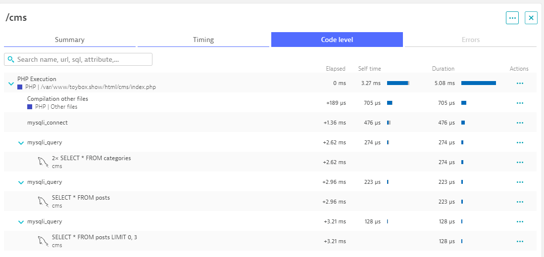

For example, there is a PHP PurePath below. I know that there are some methods which runs to do some internal executings then connect to mysql and fetch the data, but I can't see them in the code level.
It only shows that mysqli_connect & mysqli_query. There should be bunch of executed functions but I can't see them here. The only way I know is to define Custom Service to catch these methods.
Is there a complimentary tool to use with Dynatrace if I see that mysqli_connect took a long time, so I can dig in deeper to every single function/method that is executed and check their individual performance?

Hi Serhat,
Then I think you need to drill-down to the response time hotspots for the PHP execution, as per Code-level visibility for PHP
Because Dynatrace provides extensive PHP monitoring capabilities:
  • All database statements and SQL metrics
  • Compilation, execution, and response time analysis
  • Detailed request and response metrics
  • .... and more!
