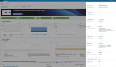

this one is Infraonly, this one not showing metadata
this one is fullstack
I can see already your properties in the bottom on your screen, NodeType, Compliance... Metadata is there as expected.
Best regards
yes but that is for fullstack server,   server 844 is not showing metadata, in configuration it has same metadata as server 840
If you have 2 hosts, with same OneAgent version, with same OneAgent mode and one is working and another not, I would open a support ticket.
