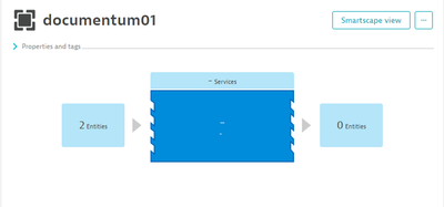

Hi.
Both ways ingest metric, OK.
But I see a difference, API v1 I can see the metrics in the CUSTOMDEVICE infographic.
Example:
And with API v2, not.
Example:
Do you know if this is so? Or should i do something?
