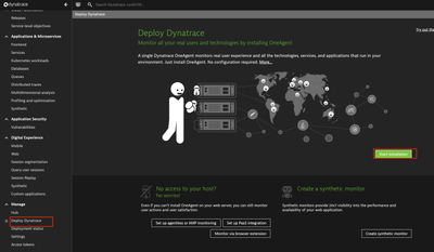

Hi Prashanth,
Install the Dynatrace agent is very easy, once you have your Dynatrace environment:
1) go to the bottom left menu and select "Deploy Dynatrace" then "Start installation"

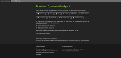

2) Select the OS where the agent will be installed
3) Follow the steps (create a token and copy and paste the commands on the host that you want to monitor)
