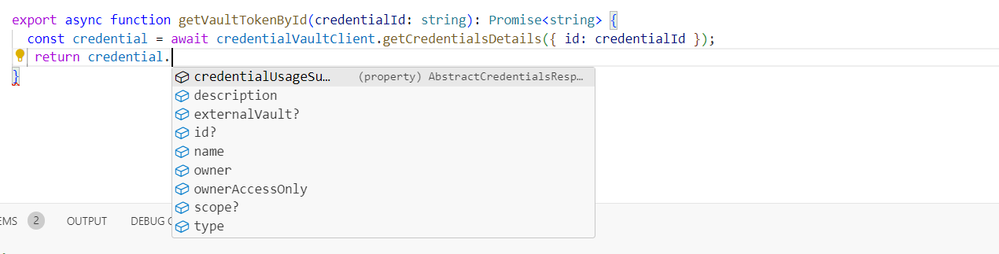

Yes, first you need to store the token in the Credential Vault, and then use it like this in your workflow code:
import { credentialVaultClient } from "@dynatrace-sdk/client-classic-environment-v2";
export default async function () {
  const credentialId = "ID_CREDENTIALS_VAULT";
  const credential = await credentialVaultClient.getCredentialsDetails({
  const baseUrl = "https://{environmentid}.live.dynatrace.com/api/v2/problems";
  const headers = {
    "Authorization": credential.token,
    "Content-Type": "application/json"
... rest of code
token_code.pngThanks for the above. I am not sure how the above is compiling for you? there is no .token you can extract, see above.
jeffrey_valerio
Frequent Guest
I’m using Workflows and that way it works, however, you could try a .type?.token according to what the documentation says."
https://docs.dynatrace.com/docs/shortlink/api-credentials-vault-put-credentials
Thanks Jeffrey for sharing that you are workflow, mine is needed as system to system and I need to use platform api call. anyway, here is what I get, maybe someone can resolve this, I see the type but unfortunately nothing after for a token 🙂
