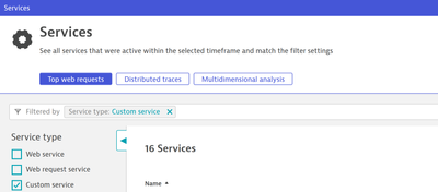

@sp72 look for custom services in your environment:
Also check if the OneAgent SDK is really used and initialized in your deployed process. You mention "Apache" - are you sure you are looking at the right process? Also, you need to look for Dynatrace services, not Kubernetes services.
Somehow I don't see Custom Service option in the service type list. These are all the options I see:
I checked OneAgent status before calling traceCustomService() and it is set to ACTIVE.
Any idea why Custom Service option might not be available in service search?
Also, is custom service name used as it is provided in the call to traceCustomService(), are there any decorations added to the name? I tried to search by name without selecting service type but search returned nothing as well.
