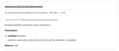

2) Can the auto-UA-mechanism be disabled?  How do I do that?

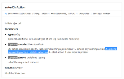

3) What's the best way to group those XHRs together?
Currently considering using something of this sort:
actionId = dtrum.enterAction("my page load")
dtrum.enterXhrCallback(actionId)
dtrum.leaveXhrCallback(actionId)
dtrum.leaveAction(actionId);

2) You can use  to enables or disables automatic action detection
3) You can check also if the use of enterXhrAction with xmode=2 will do the trick of adding subaction
