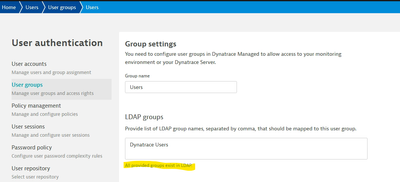

If your group/users queries return required number of items, check this group config and check if LDAP group is properly matched to Dynatrace group. In my example pic, AD group with name "Dynatrace Users" is properly mapped to Dynatrace group "Users" - see yellow labeled message.

Check your group in Dynatrace if it's mapped to AD group.
