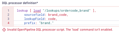

Enriching data upon ingest with lookup data doesn't seem to work. I tried to use the lookup date feature in OpenPipeline and it also reports that "load" is not enabled:
