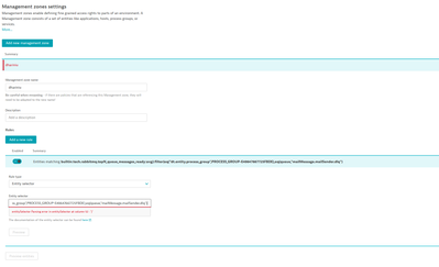

Assuming that the sentence is well formed, I recommend you go to Management Zones and create one using entity selector:

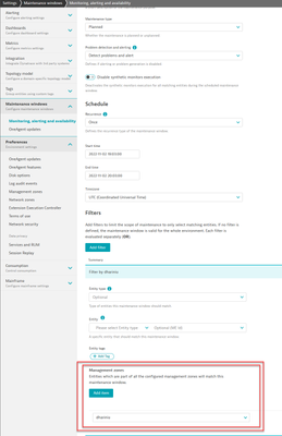

And when you create the MW use this:
that does the trick
