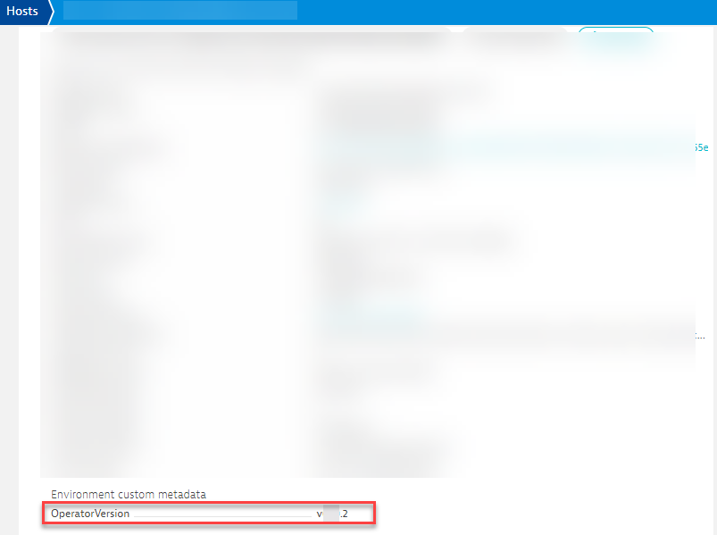

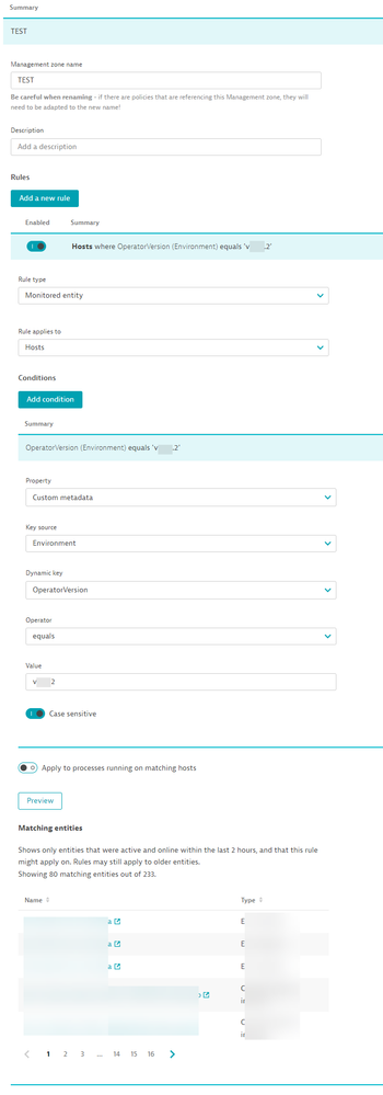

I was able to complete this ask. Granted this is set at the host level but can be applied to PG instances via PGs with the following:
-Chad

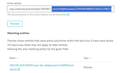

My example rule for autotaging:
type(process_group_instance),processType("NGINX"),customPgMetadata("[ENVIRONMENT]DOG:CORGI")

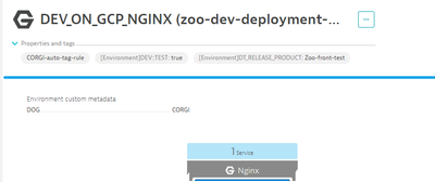

Result:

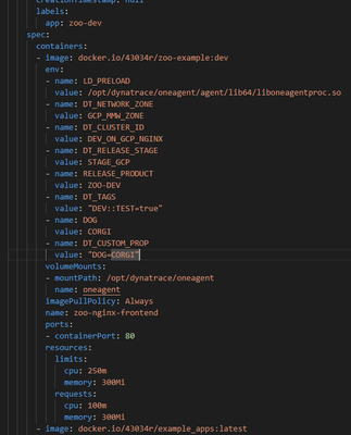

Manifest:
yaml:
        - name: DT_CUSTOM_PROP
          value: "DOG=CORGI"

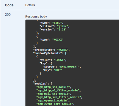

This is response from API (ENV v2) /entities/{entityId}
I have to use this API to create right entityselector. It is really helpful. You need to define only EntityID - from browser -PROCESS_GROUP_INSTANCE-XXXXXXXXX and you will get all properties in JSON.
