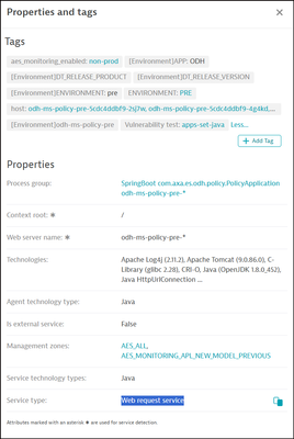

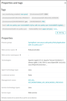

Please find attached the screenshots with the properties of both services and the process group for your reference.
Web service:
Web request service:
PGI:
My objective is to merge both services into a single service entity, if possible.
The main reason is to have all relevant information (failure rate, response time, etc.) in one place. For our technical team, it is quite challenging to get a clear view of the health of the microservice when the related data is split across two different services.
Is it possible to merge these two services in Dynatrace, or is this separation a technical limitation due to the detection mechanisms?
