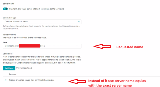

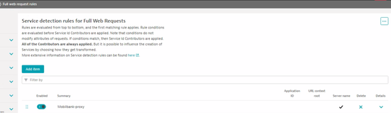

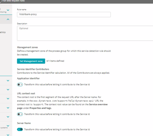

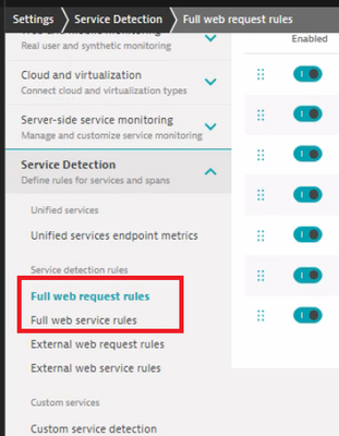

Hi @F_Vargas,
I would use these settings depends on thr service type webservice or web request service.
Example is a web request servcie but you can do the same at web service also, so I would 5 similar rules with differnt conditions (server names):
I hope it helps.
