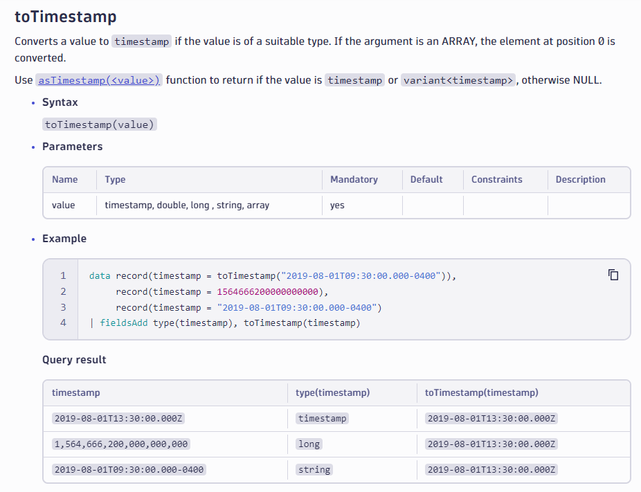

If you already upgraded to Log management and analytics (GRAIL), You can use the DQL to convert the data type of your timestamp. See this example:
Reference: https://docs.dynatrace.com/docs/shortlink/conversion-and-casting-functions#toTimestamp

Thanks @cesarsaravia for your response.
The timestamp value (2024030602500000) what I am trying to convert is not the Unix Epoch time, and when I try to convert the value, it gives me the following, which is not correct.
Query: data record(timestamp = 2024030602500000)
| fieldsAdd type(timestamp), toTimestamp(timestamp)
Output: toTimestamp(timestamp)
1970-01-24 15:43:50.602
Please let me know if I am doing anything wrong.
