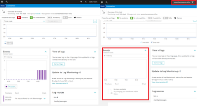

This is an example. I need to create a management zone for 1 host.
With new UI I haven't all metrics when I have rules like:
  • Entities matching type("host"),entityName("somewhere") - host
  • - entityId("CUSTOM_DEVICE-13205DA6807524D6") - Alertmanager
  • Hosts where Host group name equals "somegroup" - normal rule for host
What rule I need to add to this management zone to see ALL metrics & events for host in new-host-ui-version like we had in versions 1.150-230 😍
Have tried with metric - builtin:osservice.availability, different splits, but same result:
Dimensional rule for ANY where DIMENSION 'dt.osservice.name' equals with 'alertmanager'

Interested in os:service object. I successfully added this object to MZ, but there is no events from this object on host level. Without MZ - I can see full information as expected.

That's odd. I have just tested in my env (SaaS 1.286).
I have a MZ with a rule to "Hosts where Host group name equals "somegroup"", I have then added a fake Process availability rule, just to make sure I could replicate the same kind of availability event, and it does appear with and without the MZ selected...
No other crazy rule in my MZ.
You may have a bug there... 🤔
