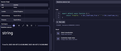

My company just received the updated dashboards this week 8/1/2023. It took several emails to our support reps at Dynatrace to get updated.
Here is a simple function to test with once you have been upgraded.
export default async function () {
return "From/To: " + $dt_timeframe_from + " " + $dt_timeframe_to;;
03 Aug 2023 06:41 PM - edited 03 Aug 2023 06:44 PM
Ah that is wonderful @scott-smith . I knew about these variables, just did not work yet on our tenant:
$dt_timeframe_from
$dt_timeframe_to
I tested today and it works!
Thanks for the snippet.
