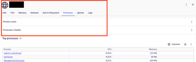

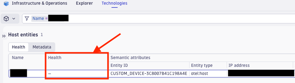

I'm monitoring a Windows Server 2025 host with OpenTelemetry Collector Contrib (v0.150.1) and sending metrics to Dynatrace via OTLP. Most metrics are flowing correctly (CPU, memory, disk, filesystem), but two key issues:
  1. Health column remains empty (shows -) in the Hosts view
  2. Process Count and Processes Created metrics are not visible in Dynatrace despite being configured and exported
Configuration

Metrics Being Collected & Exported
 system.cpu.utilization (10s)  system.memory.utilization (10s)  system.processes.count (10s, 5m, 1h)  system.processes.created (10s, 5m, 1h)  system.uptime (1h)  system.cpu.load_average.1m/5m/15m (across intervals)  system.memory.limit (1h)  system.cpu.logical.count & system.cpu.physical.count (1h) All Windows perfcounter metrics (transformed to windows.* namespace) All system resource attributes (host.name, host.arch, os.type, os.description, os.version, os.build.id, etc.)
Verified: Metrics are reaching Dynatrace (visible in (configured in 3 separate scraper intervals) 2. Removed cardinality filtering to ensure all metrics pass through 3. Verified both system.processes.count and system.processes.created metrics are in the config 4. Verified resource detection is enabled with 13 attributes 5. Confirmed sending_queue and batch processors are configured 6. Checked that metrics have correct data types and values 7. Ensured all metrics flow without errors in collector log with 13 attributes 4. Confirmed sending_queue and batch processors are configured 5. Checked that metrics have correct data types and values 6. Ensured all metrics flow without errors
Current State
  • Collector runs without errors
  • All metrics export successfully to Dynatrace
  • Mey are process count metrics and health status not appearing in Dynatrace?**
  1. For Process metrics: system.processes.count and system.processes.created are configured, exported, and flow without errors. Why don't they appear in Dynatrace UI?
    • Missing a required attribute or dimension?
    • Wrong metric naming convention?
    • Requires a different field/resource mapping?
  2. For Health Status: What does Dynatrace need to calculate and display health status for a Windows host?
    • Is there a specific health status metric (system.status, host.health, etc.)?
    • Do I need additional metrics beyond what's currently collected?
    • Is there a minimum frequency or volume requirement for health calculation?
    • Should I be exporting collector internal telemetry (otelcol_* metrics)?
  • Is there a Dynatrace-specific configuration or entity type required?

Any guidance appreciated! 🙏
patmis
Guide
UPDATE: I also tried the the Dynatrace OpenTelemetry Collector Distribution. However, it seems that this distribution is not capable of collecting the Windows Event Logs.
