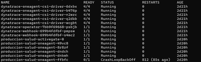

Hi everyone,
I'm hoping someone in the community can help me with an issue I'm having. I recently updated to the latest version of Dynatrace, which is installed using HELM, and I'm now encountering a problem.
My environment is Kubernetes on Azure.
Any assistance would be greatly appreciated.
Describe POD
Pods Logs
bsnurka
Dynatrace Advisor
Dynatrace Advisor
Hey Ellery,
Interesting problem you've brought forth! The logs at the very end make it seem that somehow OneAgent was installed on the Azure hosts that makeup the AKS cluster, and then we also attempted to install Dynatrace Operator to monitor the K8s cluster itself. Per the logs suggestion, I would advise we uninstall OneAgent from the AKS hosts first, and then re-attempt our deployment of Dynatrace Operator.
As shown in this document AKS clusters can follow the standard Dynatrace Operator deployment without additional configuration changes needing to be made, and we should not need to install OneAgent onto the Azure hosts themselves.
I was able to fix it, the problem was that I wasn't uninstalling or deleting the installation files from last month, and even though I uninstalled them, the files were still there, so what I did was look for the dynatrace folder in /host/ and delete it manually, then I installed dynatrace again using helm without any problems.
