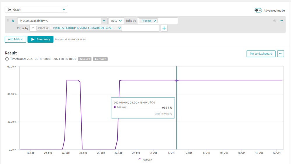

Hi, @olegus , try the metric builtin:pgi.availability, https://www.dynatrace.com/support/help/observe-and-explore/metrics/built-in-metrics#other-process-me...
Combined with the GET Metric Data points API: https://www.dynatrace.com/support/help/dynatrace-api/environment-api/metric-v2/get-data-points
Example:
curl --location 'https://tenant.live.dynatrace.com/api/v2/metrics/query?from=now-7d&metricSelector=builtin%3Apgi.availability%3Afilter(and(or(in(%22dt.entity.process_group_instance%22%2CentitySelector(%22type(process_group_instance)%2CentityId(~%22PROCESS_GROUP_INSTANCE-E0AD0B6FE4F5EBC8~%22)%22)))))%3AsplitBy(%22dt.entity.process_group_instance%22)%3Asort(value(auto%2Cdescending))%3Alimit(20)' \
--header 'Authorization: Api-token dt0c01.4OHVEPBHJGFYCVRCPHAI4FU4.tokenwithrightscope'
If you are looking for a "non supporter technology" or non detected service, you can set up the OS Monitoring Service Monitoring, https://www.dynatrace.com/support/help/platform-modules/infrastructure-monitoring/hosts/monitoring/o... ,  and then the metric builtin:host.osService.availabilityhttps://www.dynatrace.com/support/help/observe-and-explore/metrics/built-in-metrics#os-service
Try and let us know.

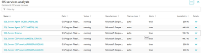

Well.. I'm confused how availability metric is calculated.
I am playing with different options and looks like this short form returns what I need :
(builtin:osservice.availability:filter(contains("dt.osservice.display_name","SQL Server B")))
EXCEPT that result values does not look like percentage to me. For instance, I found a day and time where SQL services were down for a short period and I am trying to get availability metric for "SQL Server Browser" service (see request above) with 1 day resolution and 5 days time period.
This request returns these values:
"timestamps": [
                        1697414400000,
                        1697500800000,
                        1697587200000,
                        1697673600000
                    "values": [
                        5.999304105775922,
                        6,
                        6,
                        6
As far as I understand, "6" should be 100% and "5.999" should be 99.9...%.
Host page correctly shows Availability for this exact service:
The metric that is used to show service availability on Host page has a filter for a specific entity ID. :
(builtin:osservice.availability:filter(eq("dt.entity.os:service",CUSTOM_DEVICE-FCB38F0D778F9026))
I'd like to use another filter - filter(contains("dt.osservice.display_name",...) that would in theory return availability for all services from all hosts in the specified management group that fall under this filter.
Is it feasible?
