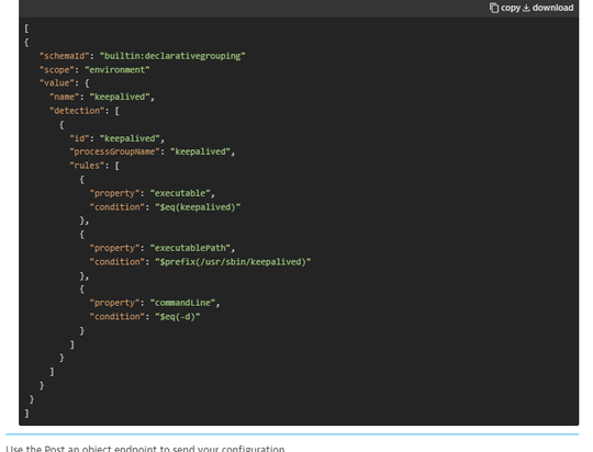

Can't you add the command line in there? Unfortunately this has to be done for every instance I think..
You can use the API for this to speed up the process..
